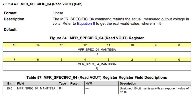

    For TPS53647 the READ_VOUT (8Bh) register is in VID format. There is a VID table in section 7.3.10 of the device datasheet to convert this hex value to voltage.
    Using this table for 0x007C gives 0.865V which is much closer to what is reported.

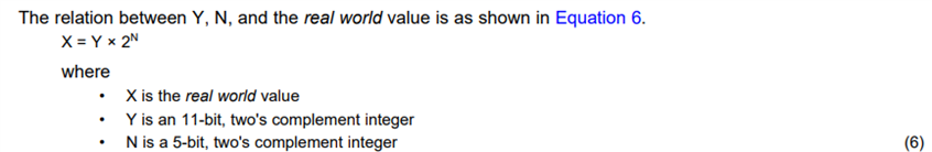

    There is also register D4h, MFR_SPECIFIC_04, which can return VOUT in a linear format and be converted to voltage using equation 6 in the datasheet.
    The datasheet for TPS53647 can be found on TI.com: https://www.ti.com/product/TPS53647
