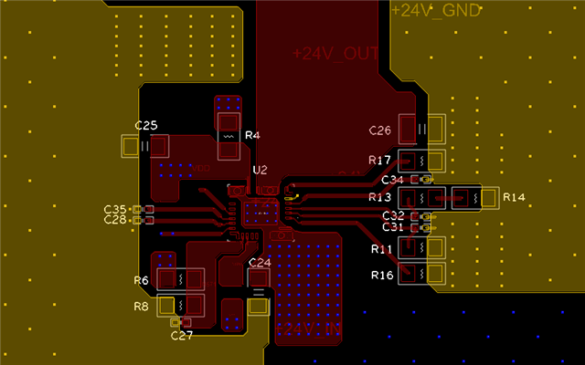

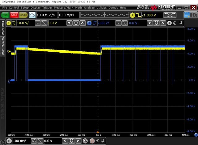

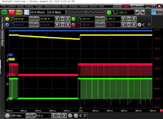

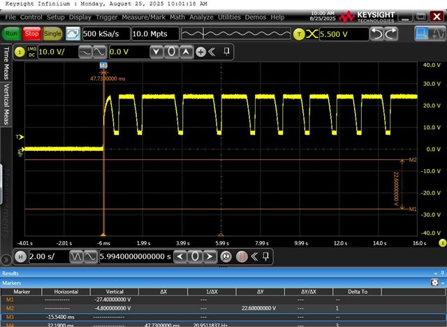

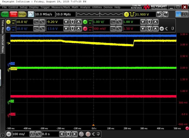

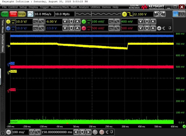

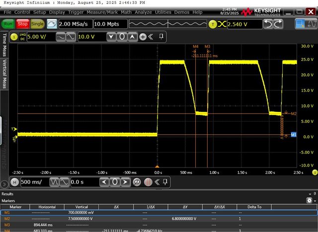

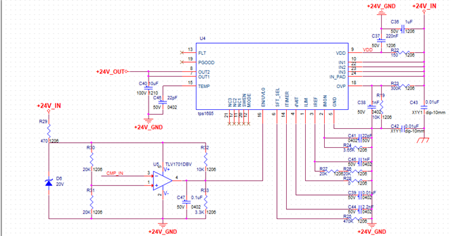

TPS1685: It's not working properly. Please give me some suggestions.
Part Number: TPS1685
The TPS1685 on our board has been failing to output normally. We use a 24V input and have measured the voltages of the following pins:
SWEN (floating): 5V
MODE (floating): 4.6V
EN/UVLO: 4V
OVP: 0.77V
IREF: 1V
ILIM (grounded): 0V
It seems that neither the voltage protection nor the current protection has been triggered, but the output is only 1.8V, which makes it unable to work properly. Could you please provide some debugging directions or suggestions?
