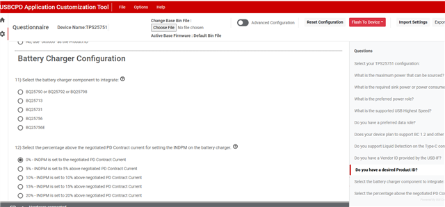

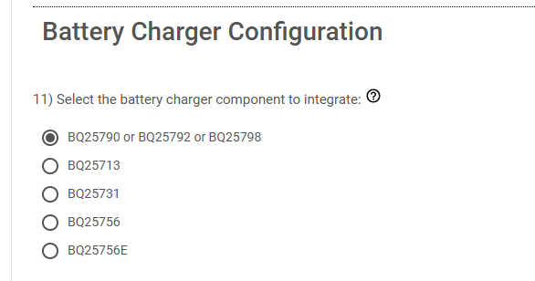

Hello TI Support,
We are integrating the TPS25750DRJKR (with no external EEPROM if possible) with a BQ25792RQMR charger. Our host MCU must load the TPS25750 patch + application configuration at boot via the I2C target interface (I2Ct), then allow full PD / PPS and charger management.
Could you please help with the following essential points:
  1. Technical Reference Manual / Register Map: How can we obtain the TRM (including the I2C host download protocol)? Is an NDA required?
  2. Image Reuse: Can the binary produced by the Web GUI (intended for EEPROM) be used verbatim for host (I2Ct) download, or does it need transformation/encapsulation?
  3. Minimal Download Sequence: Required steps to (a) detect BOOT mode, (b) initiate transfer, (c) send data blocks (recommended block size / timing), and (d) command execution of the loaded image. An example or script reference would be very helpful.
  4. Charger Coordination: Is there an application note or example showing how the TPS25750 coordinates PD/PPS changes with BQ25792 register updates when PPS voltage/current changes?
If you can provide (or advise how to request) the TRM and any example resources, we will proceed with integration.
