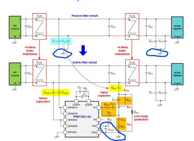

TPSF12C1: HOW TO CONNECTE THE GND?
Part Number: TPSF12C1
The GND diagram of the device is connected to the earth, but the GND of the VDD I use is not the earth, but the GND of the switching power supply. So how should the GND of the device in use be connected? If the GND of the switching power supply is connected to the earth, then the chassis housing is at risk of becoming electrified.
