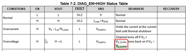

Hello team,
please refer the table below
what is the over voltage threshold here what are Vs,ovpr and Vs,ovprf
Hello team,
Hi Tanmay,
The TPS1HTC100-Q1 does not have OV detection; it is a typo and it will be fixed in the next revision of the datasheet. The TPS1HTC30-Q1 does have this feature. Sorry for the confusion!
