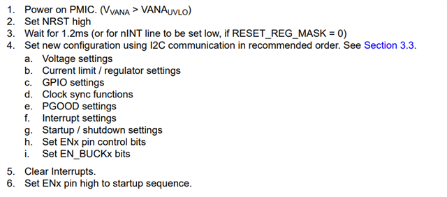

    This will follow similar steps to the LP8756x family: https://www.ti.com/lit/pdf/SNVU590
    When nRST is high, before any EN pins are high, changes can be made to the setting registers over I2C.
    Let me know if there's any questions or help needed with this process.
