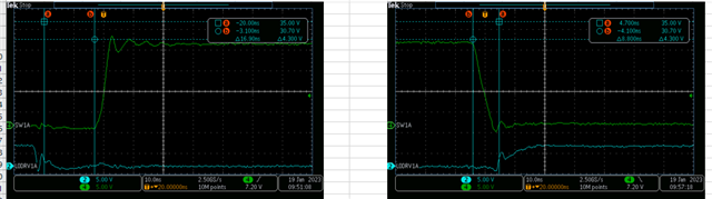

    We don't have an official document to measure deadtime, but here is an example of measuring the rising and falling dead time of a different BQcharger device.
    Falling dead time: the time between SWstarting to fall and LODRV starting to rise
    Rising dead time: the time between SW starting to rise and LODRV starting to fall
    There is also how to properly choose an external MOS.
    Please refer to section 10.2.1.2.4 Power MOSFETs selection in the datasheet for external MOSFET selection.
