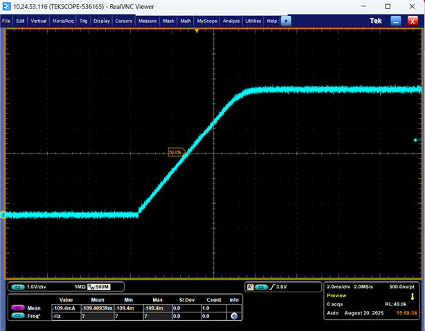

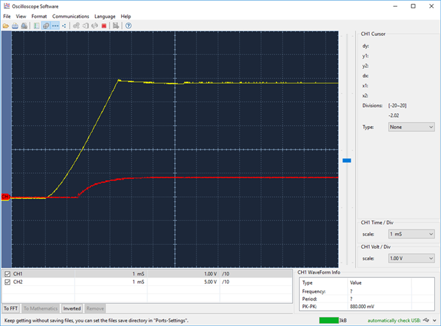

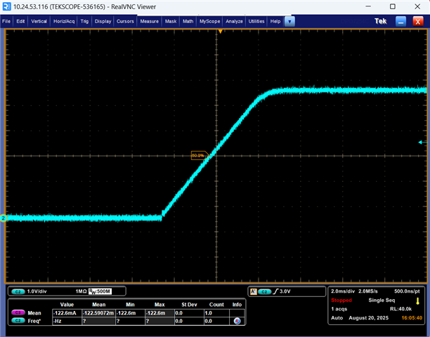

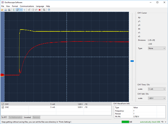

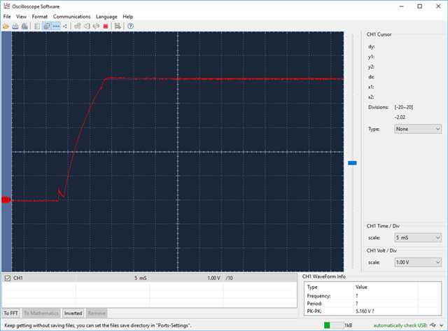

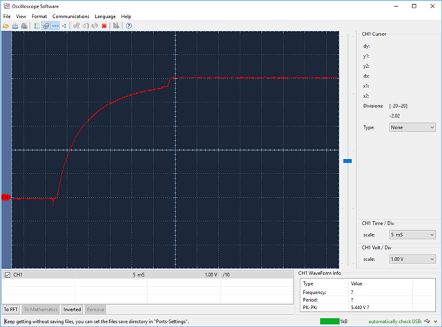

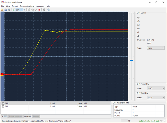

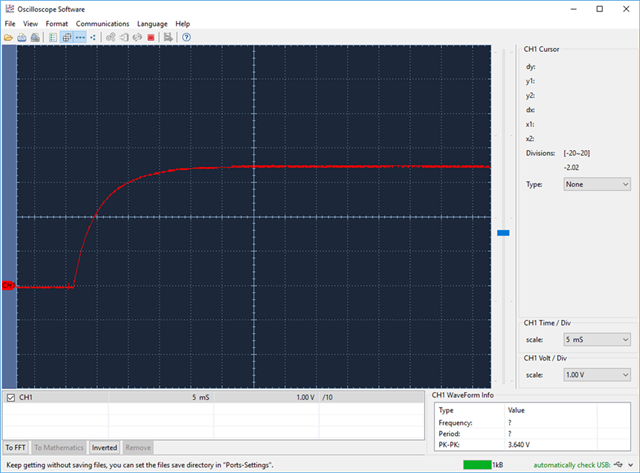

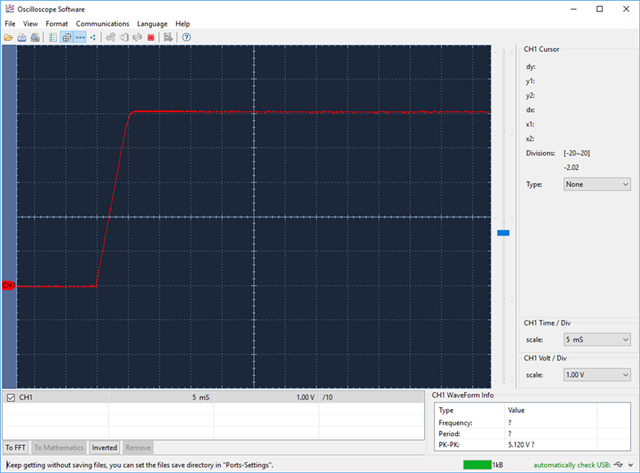

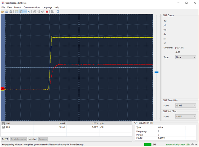

Everything is working fine as long as I connect the load resistor after powering the board. It delivers 5A at 1Ohm as stated in the data sheet.
Do I connect a load smaller than 18Ohm during power-up then the circuit does not reach the output voltage of 5V and the control loop is getting unstable. A short disconnection of the load fixes the problem.
Output voltage for different load resistors:
  No load
 Rload = 28Ohm
 Rload = 18Ohm
 Rload = 15Ohm
Does somebody have any suggestion what I did wrong?
I tried to modify C12, C7, C10 and R9 (180kOhm) afterwards. Nothing changed the behavior at all.
