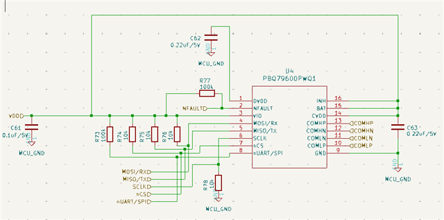

We are working on a custom BQ79600+BQ79616 application with galvanically-isolated daisy chain. Below are some setup details:
  • The daisy chain is set up as a two-device chain and we are setting the address 1 BQ79616 device as a stack device and as the stack top in the same SPI frame
  • The daisy chain is connected as a ring architecture: BQ79600 COMH is connected to BQ79616 COML and BQ79616 COMH is connected to BQ79600 COML
  • Wakeup seems to work fine as the BQ79616 AVDD, DVDD, NEG5V, etc. all come online
  • We are able to read faults from address 0 on the daisy chain after attempting auto addressing

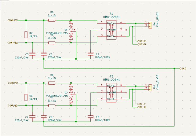

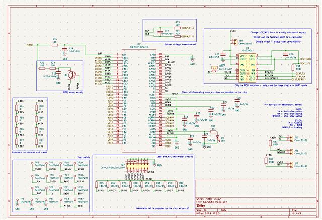

  • Please find below the schematics for the BQ79616, BQ79600, and the daisy-chain circuits. The daisy-chain is repeated on both stack devices.

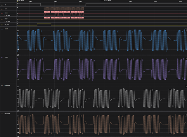

I'm attaching two .sal files with the following data transmissions:
  1. initial problem.sal - a wakeup + auto-addressing sequence where, as soon as we send the first dummy read command, the SPI_RDY pin just drops low and never re-asserts.
  2. faults and debug 2.sal - reading fault and debug registers from device 0
We would appreciate if you can point us in the right direction to debug this issue. Thanks!
  • forgot to attach the files, but it doesn't seem like there's a field for it. sorry for my ignorance

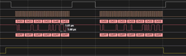

  • here is an image of the last frame we send as part of the auto-addressing sequence. I'm not sure how to upload the .sal files.
  • Zhe,
    This is indicative of an error in some part of the wakeup or auto-addressing sequence. Please double check your sequence against the ones found in section 7.3.2.3 of the datasheet.

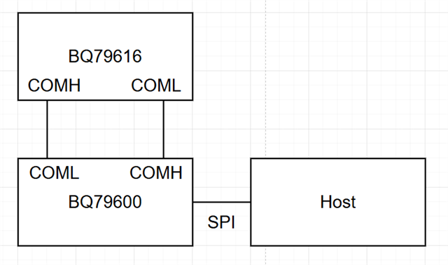

  • Thanks for your response Bo. We believe we've done our due diligence on reading that part and the two quick-start guides, but we'll keep looking at it. It would help if you could help us identify whether this is a physical or protocol layer issue.
    Another item we'd like your confirmation on is whether our daisy-chain setup is permissible under the daisy-chain protocol. Please find the setup in the diagram below.
  • Zhe,
    As far as I am aware, this setup is permissible under the daisy chain protocol. If you could share the entire Saleae log, that would be most helpful. To send it in a reply you can either drag and drop the file into the response box or use the insert->image/video/file button on the bottom of the reply box.

  • Thank you for those instructions. Please find attached the Saleae logs.
    bq_debug.zip
  • Zhe,
    Could you try to not set the BQ79600 as a stack device? In these commands you set all devices as stack devices, then set the top of stack, but never remove the stack device status from the bridge:
    Additionally, if you have any other BQ79600s, could you attempt to try on other boards? This could help us confirm where the problem lies.

  • Hi Bo, we have fixed the issue. It was a flipped daisy-chain connection on the BQ79616 side. What really threw us off here was that the BQ79616 exhibited the normal WAKEUP behaviour despite receiving a polarity-inverted tone from the base device, which led us to think that the daisy-chain was working. Hope this can help others rule out some problems, and thank you for your time.
