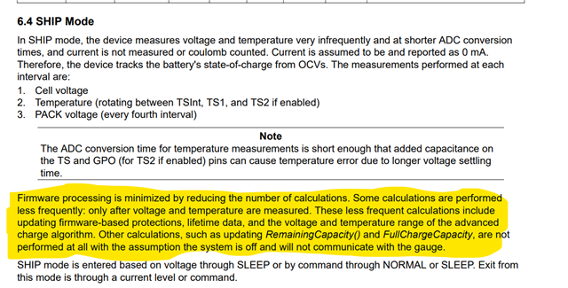

Quick question about FG BQ27Z746: In SHIP mode, can it still communicate with the MCU over I²C for metrics (e.g., voltage, temperature, etc.)?

Hello JDJ,
During ship mode only voltage and temperature are measured but at a reduced rate, and "with the assumption the system is off and will not communicate with the gauge".
