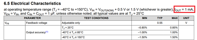

Hi team,

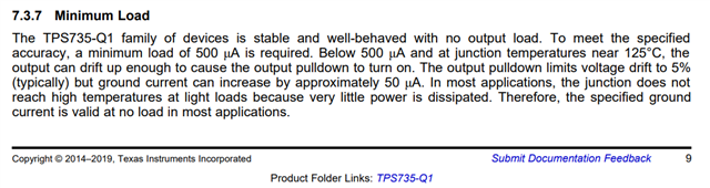

I want to check with you if TPS745-Q1 have minimum output load requirement to achieve specified accuracy? Similar like TPS735-Q1 as below.
Thanks!
Ethan Wen
  • Hello Ethan,
    The output accuracy is guaranteed with a minimum load of 1mA. It is possible that the accuracy may be achieved with lower loads, but only 1mA is tested in production and guaranteed to provide the accuracy as specified in table 6.5.
