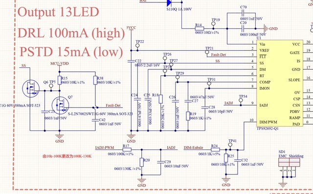

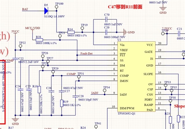

Customers need to implement both the Hiccup Mode Short-circuit Protection and the MCU detect FLT pin status.
May I know if it is possible to connect SS to FLT directly and pull up to 5V MCU-VDD via 100Kohm (MCU-VDD is the LDO output of their MCU). Is this any risk to the SS pin?

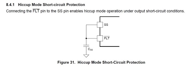

  • Hi Daniel,
    The customer would like to pull up the FLT pin to 5V as it is the OD state,  this is the same as pulling the FLT pin up to the Vref pin.
    Now they want to use the hiccup mode short circuit protection, but when designed as shown in Figure 34 or 35, they think their MCU cannot disable the SS pin in time (they have a software filter). Therefore, they want to pull down the SS pin using the FLT pin in a fault condition. With this in mind, they connect SS and FLT together and pull up to 5V.
    They want to know if there is a risk to design this way.
    Ivy
  • Hi Ivy,
    Yes, you can do that.
    but keep in mind that in that configuration, the soft start ramp will no longer be linear since your voltage source will now be contributing to the SS ramp up and, therefore, it will also effect the soft start ramp time.

  • Hi Daniel,
    Consider the soft start function, they want to use the following design (FLT pulls the SS pin down by 2 NMOS, voltage source will not be contributing to SS pin ), they think it will better than SS and FLT connect together.
    What about your suggestion?
    Ivy
  • Looks great!
