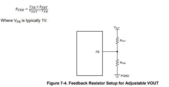

Hi Team,
My customer want to use the LMR604305SRAKRQ1 as the 2nd source for LMR604303SRAKRQ1 .
What I had learn that they already implement external Voltage divider network on FB pin.
From my understanding, if we use LMR604303SRAKRQ1 with below RFBT/B and create 3V or 3.3V VOUT,  we can directly replace it with the LMR604305SRAKRQ1.
Since the VFB are all 1V right?
Please correct me if I was wrong.
