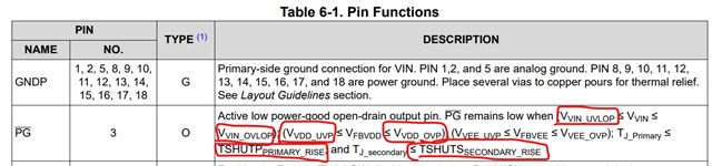

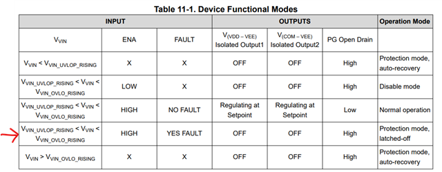

Hi team,
How much delay time is for between "_PG low trigger event happens" and  "_PG logic output is high"? are each response time as below?
(1) Triggered VVIN_UVLOP
(2) Triggered VVIN_OVLOP
(3) Triggered VVDD_UVLOP
(4) Triggered VVDD_OVLOP
(5) Triggered TSHUTPPRIMARY_RISE
(6) TSHUTSSECONDARY_RISE
In addition, is the UCC14241-Q1 _PG response time same with UCC15241-Q1?

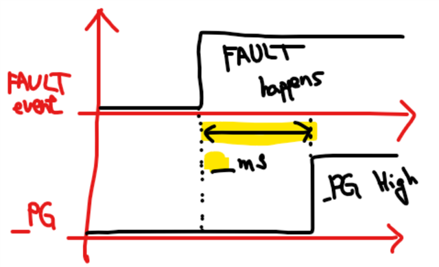

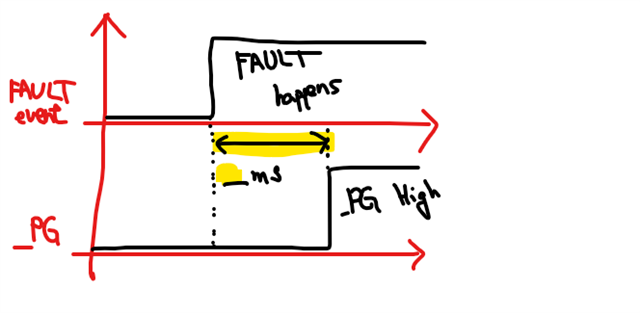

    For example, during "after powerup", could we consider total response time between "FAULT event happens" and "_PG triggered" as below figure is "degltich time" + "response time" = 66usmax + 2usmax = 68usmax?
    I appreciate if you correct me if any misunderstanding.
    • Your understanding is correct
