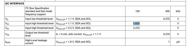

  • Hi Juan,
    While reading through BQ25125 FAQ I came across this.
    The datasheet does not mention this anywhere!
    Also look here:
    My pullups are 1v8. It should work!
    The datasheet and FAQ are at odds to each other.
  • Hi Omar,
    The I2C should work with external pull ups to 1.8V, though I'll confirm this behavior. I believe this more relates to the SYS Good signal internal to the device. It requires that the SYS rail is able to output voltage close to the configured value in order to confirm that the SYS rail is good. The SYS rail is internally used to bias some I2C level shifters so if it is not good the device disables the I2C communication.
