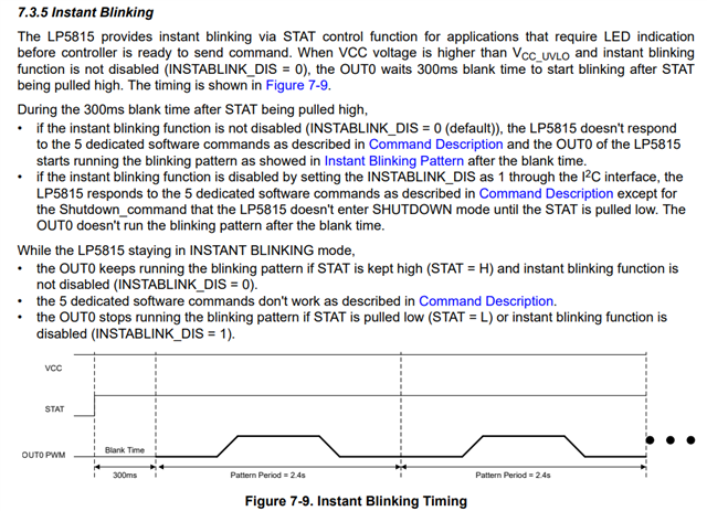

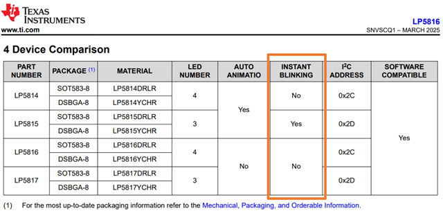

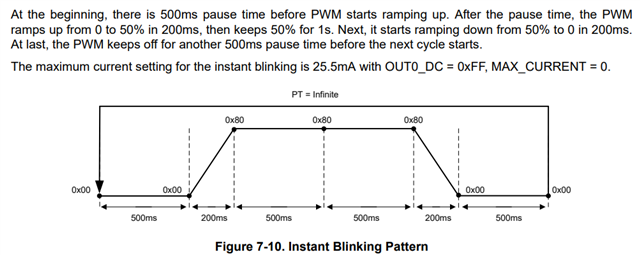

I have tried to configure the DEV_CONFIG2 and DEV_CONFIG3 as per the section 7.3.2 and 7.3.3 but only ramp up is achieved.
Question :
1. Whether Instant Blinking is achievable in LP5816 (Automatic On / Off for 1 Sec time interval)
2. If Automatic On / Off for 1 Sec time interval is possible to achieve, Kindly share us the register configuration for validation purpose.
