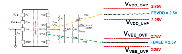

One question. Is there auto-retry mechanism device to choice when OVP or UVP is triggered with VOUT?
Brian
Brian
Hi Brian,
We do not currently have auto-retry for output UVP/OVP. These are latching protection functions.
Steve
