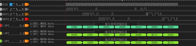

Could you please help on below two questions about TLC69627-Q1? Thanks.

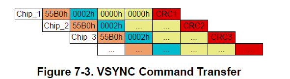

1) There are 2 devices on the SPI communication daisy chain. After sending VSYNC to the first device, the output of the two devices is as shown in below figure, hand words is 0x55B1 and it does not match the description of datasheet (55B0h). Could you please help to explain it?
2) After chip_en=1 and sending SYNC, the device can not enter the NORMAL state from STANDBY. The output of register DEV_MODE is 0X1 which means the device is still in standby mode. How to solve it?
