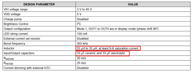

How are the selections of the boost inductor, rectifier diode, output capacitor, and input capacitor calculated? The manual only provides a reference value—is calculation not necessary?

    For the inductor selection and cap selection, you can refer to the application to do the calculation.

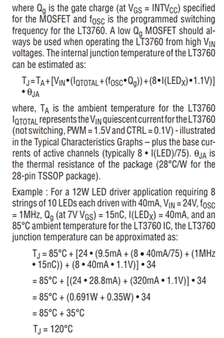

    1. May I ask in which document the formula you mentioned is recorded? I need a corresponding reference. As shown in the figure below, the calculation regarding the junction temperature of the controller chip provided in the LT3760 manual of LT is an example. I require a similar formula.
      I need to evaluate the junction temperature of the controller chip to ensure it meets the operating environmental temperature requirements of our equipment.

  • Hi, Sheng
    • For thermal estimation, it is a estimate formula depending on experience. Not mentioned in the datasheet.
    • For the component, application solution can meet most of the case. No specific formula here.

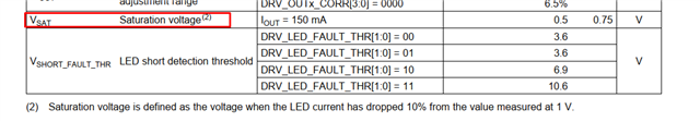

    Regarding the previously mentioned formula [Vheadroom*Iout*Channel + VDD* Iq], what parameter does Vheadroom represent? Please advise.

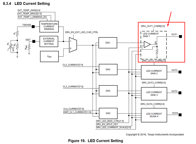

    What are the performance parameters of the MOSFET constructed as shown in the figure below?

  • Hi, Sheng
    The saturation current is what we talked about the headroom voltage. During the normal operation, OUT will have the voltage and leads the power dissipation.

    Is the VSAT mentioned above the saturation voltage of the internal MOSFET in the constant current section of the LP8860-Q1? Can I use this to calculate the power consumption of the internal MOSFET? Voltage * Current.
  • Hi, Sheng
    Sure, you calculated as that.
