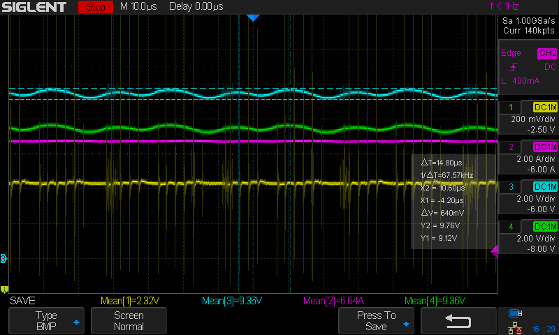

  • Hi Tim,
    Thank you for your response and for the clarification.
    We have replaced the controller, which resolved the initial issue. However, we have encountered another problem.
    The DC-DC converter operates effectively up to approximately 6A output current (Iout). Beyond this point, as we try to increase the power absorbed by the resistive load (by decreasing the load resistance), the output voltage begins to drop.
    While measuring the voltage across the shunt resistor (4mΩ) used for current feedback at Iout = 6A and Vout < 12V, we observed a voltage difference of at least 60mV. This indicates that the converter is entering current limit protection mode.
    I have attached an image illustrating this behavior:
    • CH1: COMP
    • CH2: Iout
    • CH3: Vout
    • CH4: ISNS+
    Given that the DC-DC converter is designed to supply a maximum output current of 10A, it remains unclear why it triggers current limiting at only 6A.
    Thank you for your support
    Francesco
  • Try adding an RC filter on the current sense, as you may be picking up some noise.
