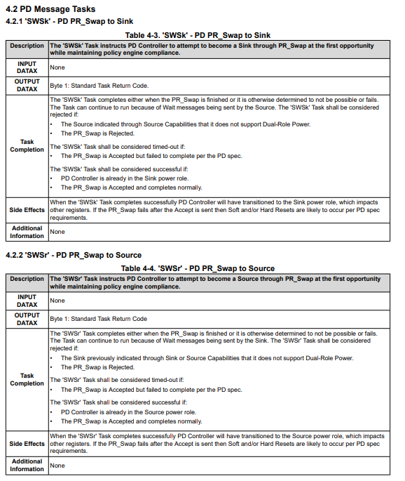

    If you have an MCU in your system, I recommended using 4CC commands to initiate the power role swaps.
    See chapter 4 of the TPS25751 Technical Reference Manual:

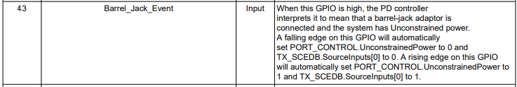

    Unfortunately, there is not a mapped GPIO event that can allow for this toggle between the power roles. We will look into the feasibility of adding this feature.
    The TPS25751 will be in dead battery mode upon powering up from VBUS only (ie. VIN3V3 is unavailable). When the Barrel_Jack_Event occurs the dead battery flag is cleared on the GPIO rising edge allowing for the power role swap to occur.  This event is typically used in applications where VBUS power is available prior to VIN3V3.

    Unfortunately, there isn't a GPIO trigger event where the PD controller initiates a power role swap at this time. Having another free GPIO pin will not allow for the behavior you are requesting. \
    Triggering the "Barrel_Jack_Event" clears a dead battery flag. This allows for the power role swap to be initiated. Whenever the TPS25751 is booted up in Dead Battery Mode, the dead battery flag is present. During dead battry mode, the main voltage is supplied of VBUS from the source and no voltage is coming in through VIN3V3. The TPS25751 can only act as a sink becuase VIN3V3 is not present, and the dead battery flag is still present. Once you add voltage over VIN3V3 and the Barrel_Jack_Event is triggered (i.e the dead battery flag is cleared) the sink can request a power role swap to source.
    With that being said the behavior above cannot be reverse to change the source back to a sink.
    See definition of the trigger event below:
    Like I previously stated, we will look into the feasibility of this feature, but at this time you would need to use a MCU to send the 4CC commands to swap.
