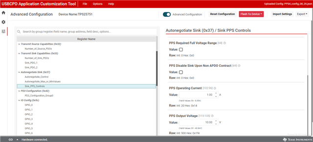

  • I wanted to see if I could get 10V since that isn't one of the fixed offerings.
    I changed Transmit Sink Capabilities PDO2 Minimum Voltage to 10.0, and regenerated the full binary and flashed the eeprom.
    The PD still asked for 9V.
    Is there something in the json that is overriding the Transmit Sink Capabilities?
    Did you update the Sink_PPS_Controls?
    Chris
  • Yep, that was it.  If Sink_PPS_Controls governs, why have a PPS_SInk PDO at all?
    I tried finding something in the json saying 9v or 10V, decimal or hex, and didn't find anything.
    It looks like the register numbers are decimals of the hex numbers in the GUI, but I didn't get much beyond that.
    Is there a description somewhere of how to interpret the json?

  • So do I need to fill in both Sink_PPS_Controls AND the PPS_SInk PDO, or is one or the other sufficient?
    Yes.  You would need to fill in both.  The idea of PPS is that the sink is will send periodic updates within a particular PDO range - sweep the voltage up or down as the battery is charging.  Even if you only need one voltage within the range you would still need both.

  • Now that we've decided what we want is 12V 0.5A, I can't get the PD to request those.
    It keeps requesting 10V 1A, which was the last working config.
    I deleted the previous binary files, so it's not getting old content.
    If I erase the eeprom the PD doesn't start, so it's reading the eeprom.
    Is there something in the attached config that still says 10V 1A?

  • So there are four settings involved in requesting the PPS voltage and current.
    Sink_PDOn
    Autonegotiate_Control
    Autonegotiate_Max_or_MinValues
    Sink_PPS_Controls
    Or are there more?
    Or are there more?
    Not directly related to PPS.  There are others which are indirectly, for example the registers above have no meaning if you are source only.  Most of the registers align with the USBC-PD specification, so you can use that as a guide.  I will provide feedback to the larger team that a more detailed recipe would be helpful in developing applications using PPS.
