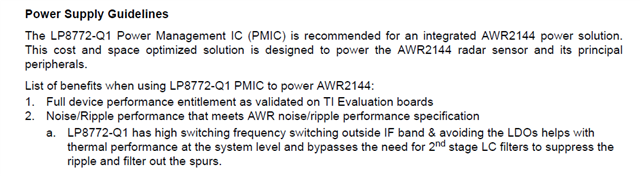

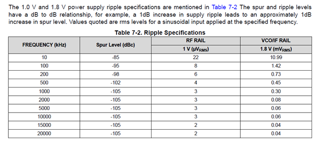

1. AWR2544 supply 1.0V by BUCK2 (not LDO). Then, Is Buck2 satisfied with the AWR2544 RF Rail Ripple specifications? I'd like to know if it's already been verified.
    Yes the bucks are low noise.
