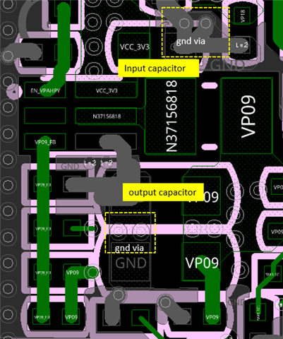

Hi TI experts,
I notice that the low side of input capacitors and output capacitors are routed together in layout guidelines.
Can the low sides of these capacitors be routed to the ground plane through separate vias?
layout guidelines
My pcb design
