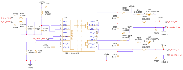

Dear Team,
I am using SiC MOSFET where it requires +20V and -5V respectively. The gate driver used is UCC21520. Could you verify the schematics especially where the ground is mentioned. The ground of 20V and -5V is added to the corresponding HS and LS switch driver side. Kindly suggest me the correction, for which whether i should give ground at the MOSFET source input from the driver out?
  • Hi Hridya,
    For your Low Side MOSFET, the source of the MOSFET (PGND4) should be connected to VSSB. For the High Side MOSFET, The source of the MOSFET should be connected to the drain of the Low Side MOSFET on the switch node. See the image below:
    For the rest of the components in your schematic, I would highly recommend checking out our Application Guide which will help you complete your schematic/layout review. I have attached it below for your convenience. If you fill this out and reply with the completed schematic/layout review, I can assist you with any further questions you may have.
