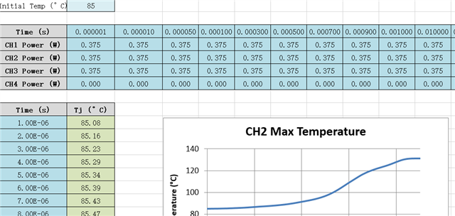

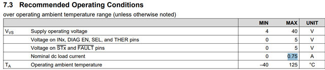

Chapter 7.3 of the manual says the maximum nominal DC load current is 0.75A. Does this 0.75A refer to the total current of all channels, or a single channel current? The manual also says that the current limit of each channel can be up to 1A~1.6A (CL pin connected to GND). This is very confusing to me, I suggest adding more description to the manual.
In my system, only three channels are used, with a maximum current of 0.5A per channel. The thermal power consumption is about I^2*R*1.5*3=1.125W, where 1.5 is the Rdson change rate. TJ_max=P*Rja+85℃=128℃, which seems to be less than T(SD,rst) 155℃. Of course, this is just a rough calculation, but I think it can still verify that the design is feasible. Can you help me review it?
Thanks.
