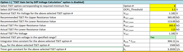

  • Hi Carlo,
    Option 1 only applies to the UCC256616, for all other variants, use option 2.
    Based on you selection for the integrator time constant, the excel calculator will recommend the correct resistor values.
    I hope this answers your question.

  • HI Carlo,
    Unfortunately no. I checked and the excel calculator is using a lookup table to select the kt value.

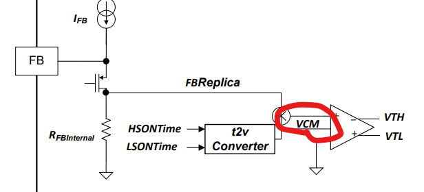

    One more thing, is the Vcm's value mentioned in the data sheet? I can't find it.
  • Hi Carlo,
    VCM is the internal common mode reference for the device here you can see it used for ISNS and how it does the IPOLARITY detection.:
    I am still checking on how kt is calculated, but suspect we will not be able to share this.
  • Hi Carlo,
    Sorry for the delay. I don't have the detailed derivation, but here are the kt values as a function of the TSET option chosen:
    TSET Option No.  TSET Voltage (V) Minimum Frequency for IPPC operation (kHz) Integrator Time Constant (ns) Maximum Dead-Time (µs) kt
    17 2.295 698.6 68 0.5 14.293
    16 2.168 591.6 80 0.5 12.104
    15 2.041 501 93 0.5 10.25
    14 1.914 424.3 112 0.5 8.68
    13 1.787 359.3 132 1 7.351
    12 1.66 304.3 156 1 6.225
    11 1.533 256.7 184 1 5.272
    10 1.416 218.2 214 1 4.484
    9 1.299 184.8 257 1 3.781
    8 1.182 156.5 304 1 3.202
    7 1.074 132.5 359 1 2.711
    6 0.967 112.2 424 1 2.296
    5 0.85 95 490 1 1.9445
    4 0.742 80.5 588 1 1.6465
    3 0.644 68.1 694 1 1.3945
    2 0.547 57.7 820 1 1.181
    1 0.45 48.9 968 1 1
