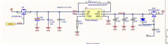

We use TPS61299QDRL for energy harvesting power management boost, our input is 0.7-5.5 volts and input current is about 5mA-15mA, The one end of the boost is connected with a full bridge rectifier and another end connected with 1.5mF supercapacitor.   the problem is the the full bridge is clamped at 1volt. Can you help why the boost clamped the full bridge output? Many thanks!
  • I need to correct the supercapacitor value. It is 1.5 F, not 1.5 mF connected in V5V.
  • We use TPS61299QDRL for energy harvesting power management boost, our input is 0.7-5.5 volts and input current is about 5mA-15mA, The one end of the boost is connected with a full bridge rectifier and another end connected with 1.5F supercapacitor.   the problem is the the full bridge is clamped at 1volt. Can you help why the boost clamped the full bridge output? Many thanks!
  • Hi Meiling,
    I suppose the TPS61299 hasn't fully start up. Could you help to see the switching waveform and inductor current.
  • Thanks for response. Extra information:  VR is almost clamped 1V. VGDA is around 3.6-3.7 volt. EN-L is high.

  • Hi Meiling,
    You are right that the large super cap may lead to this start up stuck. Could you try to start up without load?
  • we have bought evaluation board ye, it is ok with small capacitor but we need to have 1.5F capacitor connected. Can you give us suggestion to solve the clamp issue with 1.5F capacitor connected?
  • It's a little hard to start up with such large capacitor.
  • I am thinking to add a voltage supervisor at V5V, waiting for the output of the boost to reach 5v and then I connect with 1.5F supercapacitor. Or I add a timer introducing a time delay for the boost to reach 5v and then V5V connected with 1.5 F capacitor. the main purpose is let boost to start and then connect with the big supercapacitor. do you think if this is ok?
  • Hi Meiling,
    That will be great. Please go ahead with this method.
  • we disconnected with 1.5F from boost when the boost operating as normal. However, when we connected with boost again, the voltage  drops  again. any way you can suggest this mover forward? Many thanks!
  • Hi Meiling,
    I will see it and respond you later.
  • Hi Meiling,
    Could you test the input current of the boost ?
