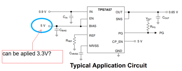

    I come back with this design. I have some questions:

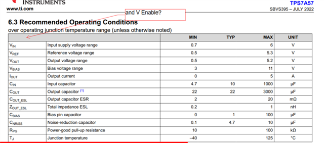

    Can be applied a 'one" (3.3v logic) to the pin EN and BIAS?
    I ask this because in the figure of typical application circuit, it is shown 5V. Same question with other control pins (if applies).
    My MCU has a 3.3V logic control lines.

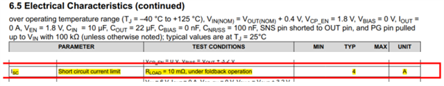

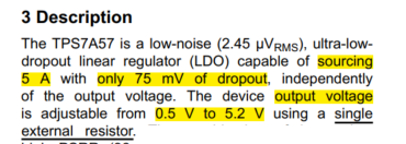

    Another question is related to the maximum current, because in the description it mentions 5 A and then in the section 6.5 a maximum current (short circuit) is specified to be 4 amps.

  • Hi Gabriel,
    If you use the BIAS pin then you'll need to apply at least 3.2V to that pin above the highest voltage you will see on your output.  Even though you are regulating current, there will still be 4.5V on the output maximum (given your specs of 1.5 ohms load and 3A constant current regulation).  So BIAS must be 7.7V or higher.  If you do not have this voltage available you can use the internal charge pump by tying CP_EN high.  You do not need the BIAS pin in that case.
    The EN pin can be used with 3.3V signals.  This is more than sufficient to turn on the LDO:
    The LDO can provide 5A all day long.  If you short the output then foldback current limit will engage.  The foldback current limit will deliver lower current, in this case 4A, to the short circuit, which will protect the LDO from damage until the short circuit is released.  Your load is 0.5 ohms to 1.5 ohms, so you should not see this in your typical operation since this is not a short (we typically test with 10m-ohms).

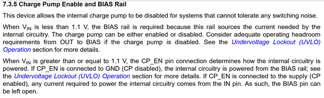

  • Hi Stephen,
    So if I connect CP_EN to high to turn it on, should I leave the BIAS pin floating?
    And I understand that as long as CP_EN is low, there's no voltage on the output, right? I know it seems obvious, but I need to confirm.

  • Hi Gabriel,
    You can leave BIAS floating if you connect CP_EN high.
    Without a BIAS rail, if CP_EN is low, there will be no output voltage.
