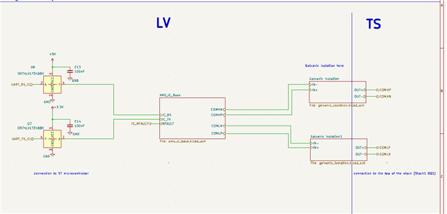

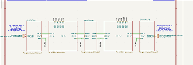

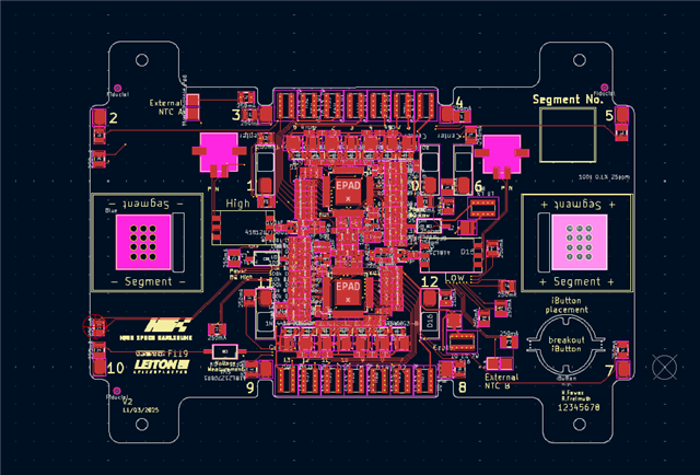

We are a Formula Student racing team from Germany, developing and building a fully electric race car. Our high-voltage accumulator operates at 600 V and consists of 12 modules, each equipped with a slave board. The system also includes a master board, which uses a BQ79616 in master mode with galvanic isolation (implemented according to TI’s recommendation with PCB-to-PCB isolation between two slaves).

Both errors occur either when the negative pole (AIR –) is closed, or when the battery’s precharge relay is closed. However, once the process succeeds even once, the battery can be used without further problems.
We have performed extensive troubleshooting: oscilloscope measurements at many points, replacement of all components, redesign of boards with improvements, cable swapping, EMC shielding with copper tape, software validation, and more. Despite this, the issue persists, and we are running out of ideas—I fear that we no longer “see the forest for the trees.”
Additional observations:
  • We do observe HV transients on the daisy-chain communication lines.

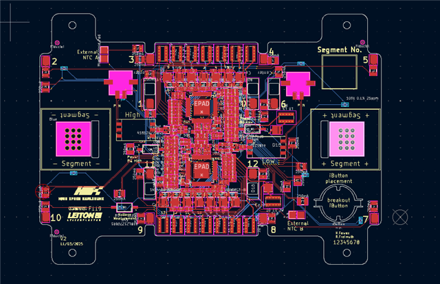

  • Each slave board hosts two BQ devices.

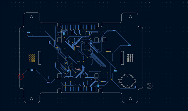

  • Our layout does not include ground planes, as we initially assumed the copper busbars beneath them would provide sufficient reference.

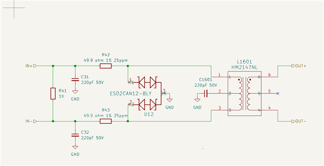

  • Hello Hasan,
    I immediately go to the com lines, with the closing of the contactors, you can induce transients on the COM pins that can soft lock the device.
    Are you sure those TVS diodes 'ESD2CAN12' are rated properly?
    We typically use the ESD562, maybe you can try swapping those in?
        Quentin

    Yes that is something that we can still try. I would like to let you know that we have tried different types of diodes, and with that we got better results and the problem did not come as often .
    This is a way to tackle maybe the root cause, however I am still interested in knowing how to remove the soft lock and get the BQ to restart. We have of course tried sending a HW Reset tone to the base device and then used it to ping up the HW reset tone up the stack.
    Is HW reset really a function that is similar to manually power cycling the BQs ? and what is the difference between both ?
  • Hasan,
    If you have some sort of soft latch in the COM pins, then a HW_RST is not going to do anything.
    The reason is because an issue on the COM pins may prevent future communication from making its way to the IC.
    Therefore, a HW_RST wouldn't work.
    A Power cycle will completely unpower all internal blocks and disable the COM pins completely removing any latching.
