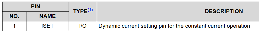

    The LM5190 is a better choice if you need to operate with CC (no external circuit required).

    Note that the LM5190 has an ISET input specifically for varying the CC setpoint...you would not manipulate the shunt (current sense resistor), as that sets up the loop for current-mode control.

    When using the LM5190, I opted not to use a fixed current detection resistor because it inevitably lowers the constant current accuracy when the current is low.
    To improve current accuracy, I ensure precision by fixing the reference voltage and varying the current detection resistor.
    I will confirm sufficiently regarding the discharge time of 4.7uF.
  • okay, sounds a bit risky adjusting the shunt, as it will change the loop gain.
