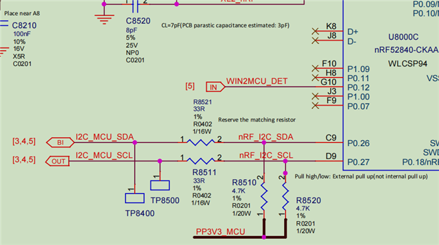

Currently i'm encounting the I2C bus hang issue when MCU(Nordic, nRF52840) communicate with BQ28Z610 as below:
NG symptom:
Randomly when MCU write register address, the 9th clock width is much smaller(2us), and after ACKed, the I2C bus always keep low(i suspect it is pulled low by BQ28Z610), and after 500ms, the I2C bus reset and recover, and randomly repeat the same NG symptom in the next time.Please see the attached log.
nRF52840 I2C intermittent failure log.xlsx

Look forward for your comments and thanks in advance.(also attached the Pack schematic and MCU I2C related schematic as below)

    This is happening on all the units in Proto build (50x units).
    nRF52840 support clock stretching, and i also tried to enable & disable BQ28Z610's stretch function by writing 0/1b to bit6 of I2C configuration setting, it didn't help on this issue.
