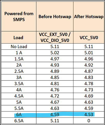

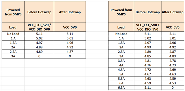

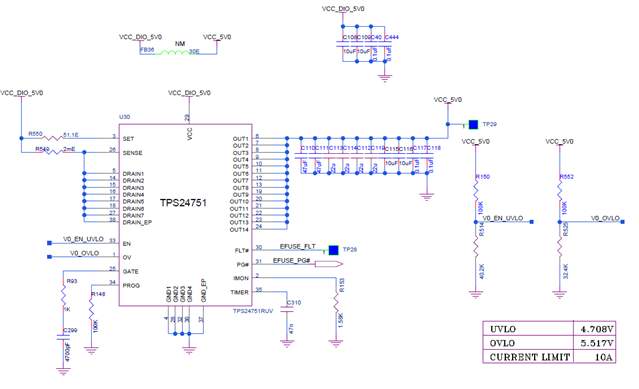

Hi Team,
We have designed the hot-swap circuit for a 10 A output current. However, during testing with a load, the hot-swap turns off at varying output current levels. Please refer to the attached schematic and table, which show the load current values at which the hot-swap powers off. The hot-swap powers off at different current levels each time. Additionally, a voltage drop is observed between the input and output. What could be the reasons for these two issues?
