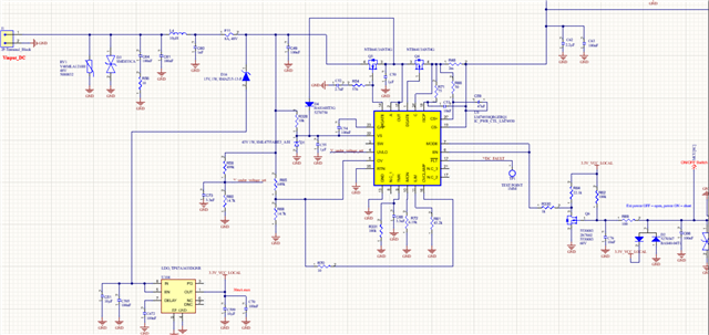

I am using TPS7A1633QDGNRQ1 in the low current circuit, among other functions, to provide a ON/OFF functionality for Ideal diode surge stopper LM74930-Q1. I have few question about the LDO.

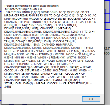

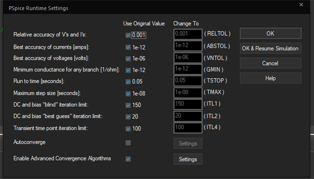

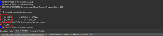

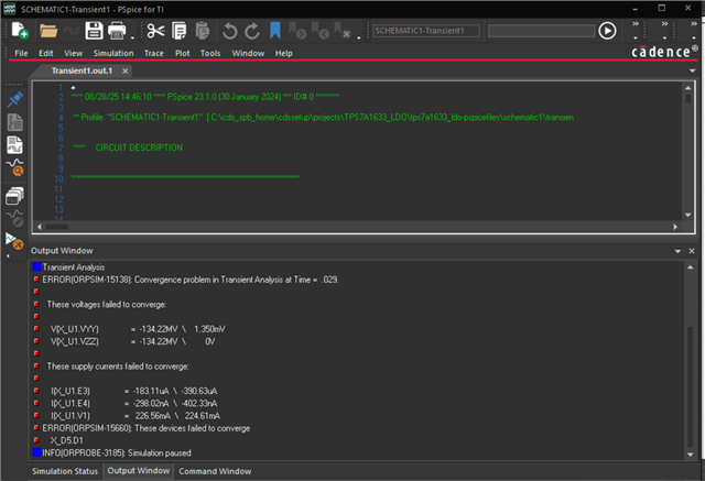

1. I am trying to simulate using TI's P-spice  models simple circuit but  tool cannot converge at all. Do you have idea how to fix it.

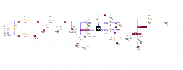

Here is the schematic:
Parameter setting:
2. I am using this LDO to switch LM74930 on/OFF plus some other functions in the system. The LM744930 works well - it switches on at predefined UV and UV conditions. However, during reverse polarity test  both  LDO and LM74930 failed for obvious reason -  lack of protection at LDO input.
Q1 Would adding series Schottky diode in LDO input path fix the reverse polarity failure? Is there any issues with LM74930 implementation?
Q2. The positive  Voltage applied at MODE or EN pin was after the  LDO failure, was 9V which should  not have damaged the LM74930, is that correct?
Q2 The Pspice model seems to be missing quotes, how to I fix it?

    The convergence issue with the TPS7A16-Q1 macromodel may be caused by the transition from positive to negative input voltage. I'd suggest adding a series diode in the LDO input to prevent its input from going negative.
    Regarding Q1, adding a series Schottky diode before the TPS7A16-Q1 should be sufficient to prevent damage due to the negative input voltage. Adding a second diode from GND to the LDO input would add additional protection as well.
    Regarding the LM74930, I'll forward this question on to the power switch group to answer.

  • Hi Alex,
    I have tried your suggestion unfortunately it does not work.
    I have changed the voltage source to positive and added series diode.
  • Hi Zenon,
    Apologies for the delayed response. Can you send me a copy of your PSpice project?
