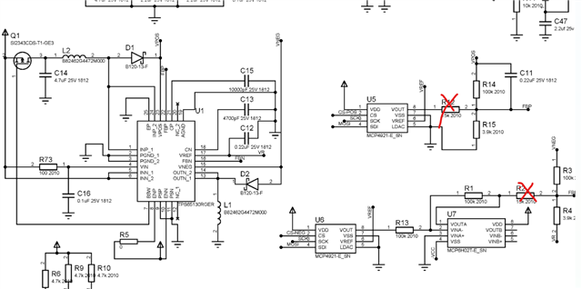

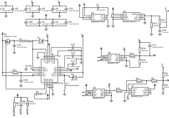

I have made a PCB based on the TPS65130 for an adjustable positive and negative power supply. After installing the components and testing the PCB I am getting strange results.
When DAQ output = 4.93 Vneg= 3.3v, 2.4v with load Vpos= 5v, 4.6v with load
When DAQ = 0 Vneg= 3.3v Vpos= 4.9v, 4.6v with load.
The FBN= 1.72 and the FBP= 1.13.
I have tested everything and tried multiple IC's and I am getting the same result.
