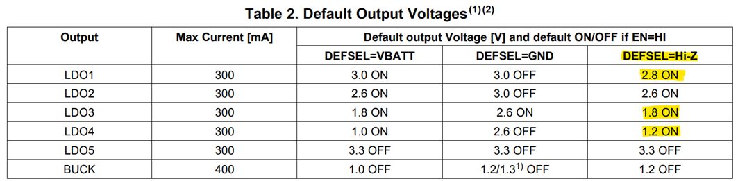

Can I get to know whether there are any similar IC TPS65000TRTERQ1 are available with 3 output as LDO.
I need 2.8V , 1.8V and 1.15V with all as LDO, because of the compact size we cant add any inductor in our design.
I need it in smaller package , as small as possible.

    Smallest package size with at least 3 LDOs would be LP8720:
    • It has 5 LDOs and one Buck
    • Each LDO supports up to 300 mA
    • 2.75 x 2.25 mm
    • It can have the following default output values when the DEFSEL pin is floating:
    • If 1.2V on LDO4 is not acceptable for the 1.15V requirement, the voltage level can be configured via I2C before EN is enabled, while device is still in standby mode.
    Otherwise, a user-programmable option would be TPS6521905
    • 4 LDOs, 3 bucks. Unused converters can be disabled.
    • LDOs 1,2 support up to 400 mA. LDOs 3,4 support up to 300 mA
    • 4 x 4 mm or 5 x 5 mm
    • User-programmable output voltage values.
    Let me know if you have any follow-up questions about either device.
    Sarah

    I would like to know whether can I get a LDO with 3-4 outputs without buck in that, also it shouldn't be BGA package.
    We are trying to design a compact board with less cost.
    I would request you to recommend such LDO with current >400mA.
    Irfan
  • Hi Irfan,
    Unfortunately we don't have any PMICs with only 3-4 LDOs in our portfolio.
    A higher current LDO >400 mA would be harder to find as well.
