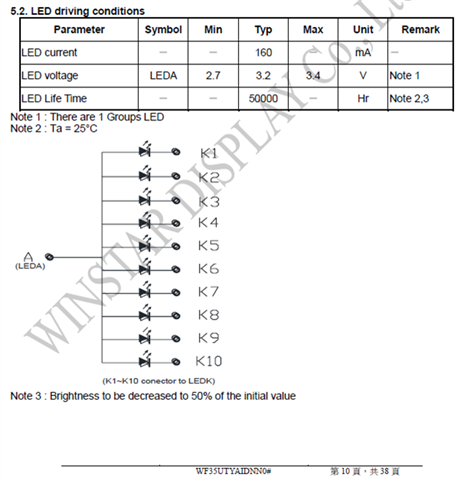

Hello, I have a 3.5" LED backlight with the following electrical specifications (10 LEDs connected in parallel, K1 to K10 tied together):
The client device uses a single lithium battery (3.3V, max. 4.2V) for power.
For the LED driver, is the LM3405A or LM36010 suitable?
Or, could you recommend a more suitable LED driver?
Many thanks for your attention!
