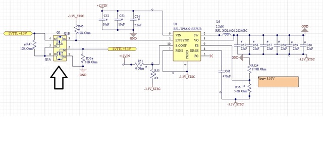

Q1A (SI1029X-T1-GE3) is going to be EOL and not recommended for new design. Would like to ask for possible replacement parts.
Vin=+12V
Vout=-3.3V

You can use this one SSM6N7002KFU,LF.
It has almost similar specification like this part SI1029X-T1-GE3.

In your schematic, Q1A and Q1b are complementary mosfet, so this SSM6N7002KFU,LF Fet would not be work, it's an only N-channel Fet.
You can proceed with NTZD3155CT1G this part.

It should be work, also please verify your requirement with datasheet of the device.
