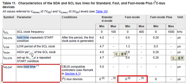

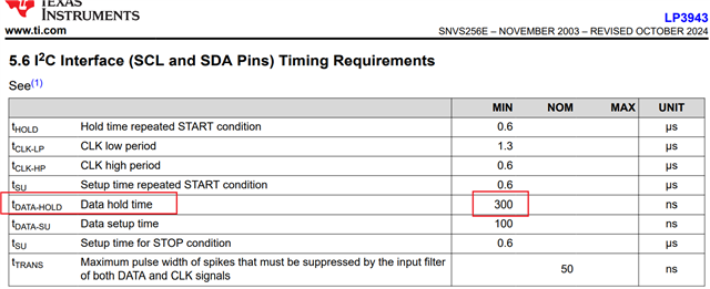

would like to check with you about the “Data hold time” requirement on LP3943.
Base on I2C standard version 7, the “Data hold time” just meet 0us, not 300ns.
Is the “Data hold time” requirement on LP3943 correct or not?

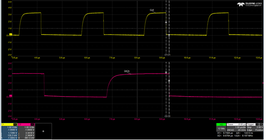

customer think can’t meet the timing requirement in current design (120ns), do you have any idea to fix this issue?

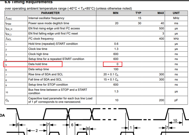

but if we look at the LP5018 datasheet, it is marked 0nS, why is there such big difference?
