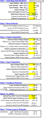

I am trying to find the calculator sheet for this power module, but the page seems to miss the actual calculator: https://www.ti.com/tool/TPSM6360XDESIGN-CALC

Please find the calculator link : TPSM63604 data sheet, product information and support | TI.com

Maybe I should open a new thread, but in the spreadsheet a junction temperature is calculated of 64 degrees.
Under what circumstance is that? I have the demo board and with the shown input voltage (30V) and output voltage (12V) and current (3A), the junction temperature is much higher at 81 degrees measured with a FLIR.
I suspect that the excel sheet will not be able to model the exact environment condition and so you see a difference in excel result and actual measurement.
