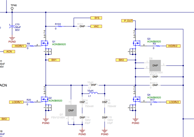

Could you please help check my schematic the buck-boost circuit?
In my design, I only use buck mode, using 30V power to charge 24V lead acid battery.
In the EVM, I think I can use diode to replace Q3 and Q6, is it right?
Could you please help explain how the circuit operate?
I use oscilloscope to test the FET drive signal. Why does Q8 also need to be driven? Thanks!
