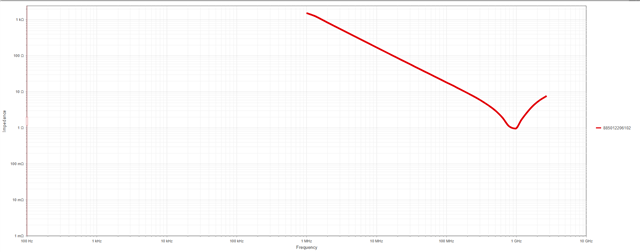

    You can design the capacitance based on the SRF (self-resonant frequency) of the capacitor. The SRF shall be larger or slightly higher than the CM frequency. As an example, an 100pF, 100V, X7R, 0603, PN: 885012206102 has an SRF ~900MHz (see below), meaning that at that frequency it provides a low impedance path to the CM currents flowing across the isolated grounds. In order to know the frequency of the CM currents, what you can do is to measure the ground bounce voltage across the isolated ground with a voltage probe and take the FFT (frequency response) in the scope. What most of customer do is to start with an estimated value (such as 100pF) and check the improvements adn from there they adjust to higher or lower capacitance.
    Regarding the resistance value, it is recommended to select a small value compared to RFB so that Vout regulation DC does not change much.

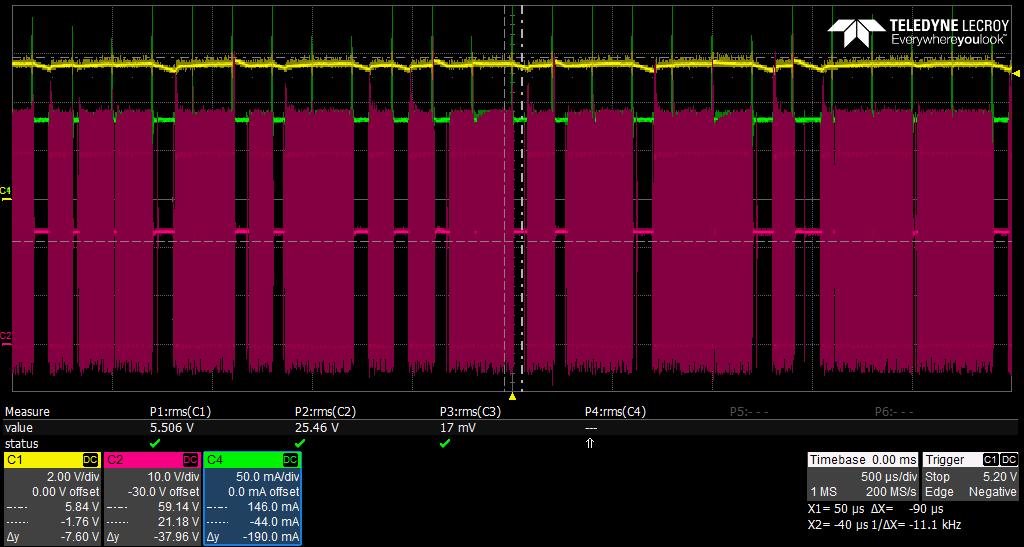

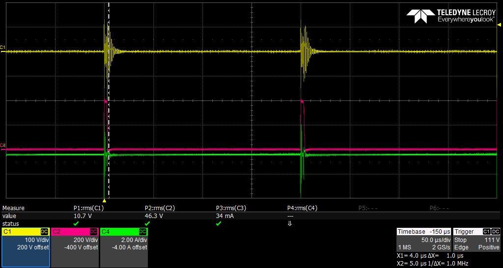

    I have measured the voltage between the secondary winding ground and the primary ground using a differential probe, and this is the result:
    C1 channel shows the voltage between the secondary and the primary ground
    C2 channel shows the phase motor voltage with respect to -HV
    C4 channel shows the current on the phase motor
    The application is an inverter drive with an IGBT module, whose commutation frequency is 5kHz, and the DC bus voltage is 400V.

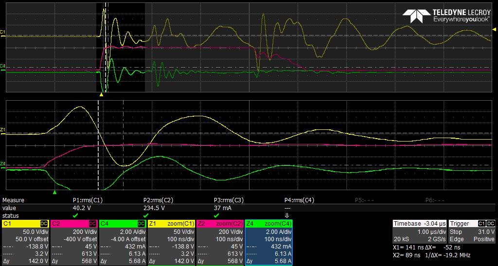

    The next image is a zoom of the first one. It better shows the signal I have between the grounds.

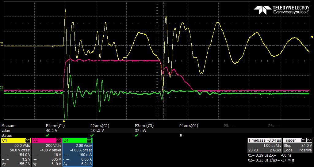

    While the next image shows the ground voltage rising edge.
    Then I can show you the effect of this CM noise on the Flyback regulation.
    C1 channel shows the secondary winding DC output voltage
    C2 channel shows the reflected secondary voltage
    C4 channel shows the secondary winding output current
    How could I filter this signal, or increase the circuit immunity to this noise, without compromising the Flyback regulation?
