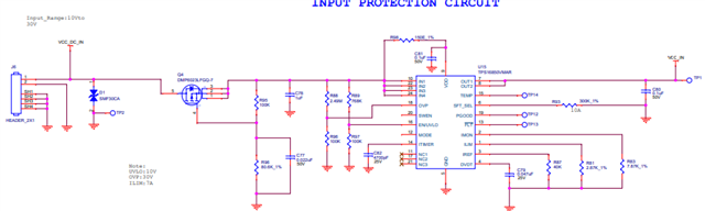

Hi Team,
We are using this part in our design. TPS16850VMAR
Could you confirm whether the following pins can be left unconnected? or is there any necessary circuits to be added.
Our requirement: 10V-30V input range and 7A current.
UVLO= 10, OVLO-30V, ILIM - 7A
1) Fault: added testpoint for debugging
2) PGOOD:
3) Temp
4) FLT:
5) SWEN
Also, let us know shall we share the schematic for review
Thanks in advance
Sathya Priya N.

  • Hi Sunil,
    thanks for the detailed inputs.
    1) Fault (pin 13 not 15?)-
    Fault: We don't have 5V supply in our board. Vin 10v-30V is the main input, also board has size and height constraints. so we will keep only TP on fault pin for debugging if fault triggered will probe the TP and check it.
    2) PGOOD - In our design this is the primary controller, so just kept TP not used for any sequencing. hope this is fine.
    3) Temp: will add 10k pulldown to gnd if mandatory. we don't have analog monitoring pin on processor side.?
    4)SWEN: this is used for sync when multiple device connected right?
    Can you provide detailed way or reference circuit? How it should be connected to UVLO pin?
    Can this pin connect to GPIO enable of 1.8V or Vin supply of 10V-30V range?
    5) VDD- connected 150ohm to IN pin as per datasheet suggestion
    I have attached the snapshot of protection circuit for your review. check and revert back to us.
    Input range: 10-30V.
    UVLO-10V, OVL-30V, Max current limit - 7A, SFT_SEL-10A,
    Sathya Priya N

  • Hi Sunil,
    One more doubt, RILIM: as per your calculation it is 714ohm. But we need to understand how you have calculated? How the value 0.005 arrived? what s the formula you used for it?
    As per datasheet, we have calculated RILIM as , RILIM = 1.1 x N (1) x RIMON (7.849k)/3 = 2.87K.
    RIMON=7.849K,  as per datasheet, RIMON= VIREF(1V)/ GIMON (18.2uA as per datasheet) x Iocp (7A) = 7.849k
    Your feedback on this will be helpful.
    Sathya Priya N.

  • Corrected Pin-by-Pin Review
    Thank you for the follow-up and for attaching the schematic snapshot. I've reviewed the provided circuit diagram based on the TPS16850VMAR datasheet details. First, I'll address your specific questions with corrections to my previous response (e.g., pin numbers were inaccurate earlier due to a mix-up with a similar device; the correct ones are FLT as pin 13, TEMP as pin 15, PGOOD as pin 19, and SWEN as pin 20). The TPS16850 has a 23-pin LQFN-CLIP package, and I've confirmed the functions, connection recommendations, and whether pins can be left unconnected based on the datasheet. Recommendations account for your board constraints (no 5V supply, size/height limits, VIN 10-30V as primary input) and requirements (UVLO=10V, OVLO=30V, ILIM=7A).
    1. Fault (FLT, pin 13): Yes, this is pin 13 (not 15 as I previously stated; apologies for the error). It's an open-drain, active-low output that pulls low to indicate faults like overcurrent, short-circuit, or overtemperature.
      • Unconnected? The datasheet strongly recommends not leaving it floating to avoid unpredictable behavior from noise or leakage. However, since you don't have a 5V supply and are constrained on space/height, keeping only a test point (TP) for debugging is acceptable if you're not actively monitoring faults in normal operation. If a fault occurs, you can probe the TP to check (it will pull low). For better reliability, if your processor has a 1.8V or 3.3V rail available (even if not 5V), add a 33kΩ pull-up resistor to that logic level—it's small and won't add much height. Pulling up to VIN (10-30V) via a high-value resistor (e.g., 100kΩ) is possible if the downstream logic can tolerate it, but avoid if possible as the pin's absolute max is typically lower (check ~5.5V rating for open-drain in similar devices). If no pull-up, the pin may float high, masking faults unless probed.
    2. PGOOD (pin 19): This is an open-drain, active-high output that asserts high when the output is stable and ready (e.g., after inrush, when VOUT is within spec). It de-asserts (pulls low) if faults occur or during startup.
      • Unconnected? Similar to FLT, the datasheet recommends a pull-up to prevent floating. But since this is your primary controller with no sequencing needed, and you're using a TP, it's fine for your setup—probe if power-up issues arise. Same advice as above: Add a 33kΩ pull-up to a low-voltage logic rail if available to ensure clean signaling. If left with just TP, it won't actively indicate issues without probing, but no major risk for non-sequenced operation in your 10-30V/7A design.
    3. Temp (pin 15): This is an analog output providing a voltage proportional to the die junction temperature (typically ~10mV/°C scaling). It's useful for thermal monitoring, especially at 7A where dissipation could reach ~0.17W (I² × RON ≈ 49 × 0.0035Ω).
      • Unconnected? Do not leave floating, as it can pick up noise and affect internal thermal protection accuracy. Adding a 10kΩ pull-down to GND is not strictly mandatory but highly recommended—even without ADC monitoring on your processor. It's a simple, low-cost addition (small resistor) that grounds the pin safely and prevents floating issues. If space is critical, you could omit it, but risk minor thermal inaccuracies; at your 7A load, monitor via other means if possible.
    4. SWEN (pin 20): Yes, this is primarily for synchronization when multiple TPS16850 devices are paralleled (stackable up to higher currents, e.g., 40A+). It's an open-drain I/O pin that controls/indicates switch ON/OFF status across devices, with a weak internal pull-up to an internal supply. For single-device operation like yours, it's not for UVLO (that's handled by the separate EN/UVLO pin).
      • Unconnected? In single mode, it can be left unconnected thanks to the internal pull-up keeping it high (enabled), but the datasheet advises against floating to minimize noise or timing issues. Your TP is a good start for debugging.
      • Detailed connection/reference circuit: For single use, tie it high via a 33kΩ pull-up to a logic rail (e.g., 1.8V or 3.3V from your processor GPIO) to reinforce the internal pull-up. Do not connect directly to the EN/UVLO pin—SWEN is for sync, not UVLO setting. Reference circuit: If paralleling (not your case), wire SWEN pins together across devices with a shared pull-up (33kΩ to 3.3V/5V). For your setup, connect to a processor GPIO (active-high enable) at 1.8V—confirm VIH min (~1.2V typical) is met; 1.8V should work. Connecting directly to VIN (10-30V) is not recommended as the pin is logic-level (abs max ~5.5V); use a voltage divider (e.g., 10kΩ from VIN to SWEN, 4.7kΩ from SWEN to GND) to drop to ~3V if needed, but avoid if possible due to your height constraints. If no GPIO, leave with TP and rely on internal pull-up.
    5. VDD: Connecting via 150Ω to the IN pin (VIN) is correct per datasheet recommendations for decoupling and stability. This provides internal bias (typically ~5V output on VDD for gate drive). No changes needed.
    RILIM Calculation Feedback
    Your calculation is correct based on the TPS16850 datasheet, and my previous formula (RILIM = 0.005 / ILIM ≈ 714Ω) was incorrect—apologies, that was from a different eFuse family (e.g., TPS259x series). Let's break it down step-by-step using the datasheet equations for your 7A requirement.
    • Step 1: Calculate RIMON for the overcurrent protection threshold (I_OCP = 7A). The current monitor (IMON pin) sets the accurate OCP via: RIMON=VIREFGIMON×IOCP R_{IMON} = \frac{V_{IREF}}{G_{IMON} \times I_{OCP}} RIMON=GIMON×IOCPVIREF
      • VIREF=1V V_{IREF} = 1V VIREF=1V (reference voltage, set via IREF pin).
      • GIMON=18.2μA/A=18.2×10−6A/A G_{IMON} = 18.2 \mu A/A = 18.2 \times 10^{-6} A/A GIMON=18.2μA/A=18.2×10−6A/A (current monitor gain).
      • IOCP=7A I_{OCP} = 7A IOCP=7A. Calculation: RIMON=118.2×10−6×7=10.0001274≈7849Ω R_{IMON} = \frac{1}{18.2 \times 10^{-6} \times 7} = \frac{1}{0.0001274} \approx 7849 \Omega RIMON=18.2×10−6×71=0.000127417849Ω (your 7.849kΩ is spot-on; use a standard 7.87kΩ or 7.5kΩ with 1% tolerance for accuracy).
    • Step 2: Calculate RILIM for the circuit breaker/fast-trip threshold. The ILIM pin sets a higher "circuit breaker" threshold (e.g., for short-circuit protection, often 1.5x–3x OCP to allow brief surges). The datasheet provides a formula adjusted for stacking (N devices) and margin: RILIM=1.1×N×RIMON3 R_{ILIM} = 1.1 \times N \times \frac{R_{IMON}}{3} RILIM=1.1×N×3RIMON
      • 1.1: Safety margin factor (to account for tolerances/variations).
      • N = 1 (single device in your design).
      • Divide by 3: Sets the circuit breaker ~3x higher than OCP for fast response to severe faults (e.g., ~21A trip here, allowing headroom above 7A). Calculation: RILIM=1.1×1×7.849k3=1.1×2616.33≈2878Ω R_{ILIM} = 1.1 \times 1 \times \frac{7.849k}{3} = 1.1 \times 2616.33 \approx 2878 \Omega RILIM=1.1×1×37.849k=1.1×2616.332878Ω (your 2.87kΩ is correct; use a 2.87kΩ or 2.8kΩ 1% resistor). This ensures OCP at 7A (via IMON) and faster circuit breaker action at higher currents. If your SFT_SEL is set for 10A short-circuit response (as noted), this aligns well—SFT_SEL likely configures fault timing or secondary threshold (e.g., via resistor for 10A soft-fault level).
    Schematic Review
    Your protection circuit looks solid overall for 10-30V input, 7A max, with good basics: reverse polarity protection (Q1 CMPFJ175 JFET), transient suppression (D1 SMAJ36CA clamps at ~36V, suitable for 30V max), inrush control (C2 0.1uF on dV/dt), and output filtering (C3 0.1uF). VDD biasing (150Ω) and IMON/RILIM values match calculations. However, here are key feedback points:
    • Strengths:
      • Input fuse (F1 5A) provides basic protection, but see note below.
      • TVS diode (SMAJ36CA) is appropriate for transients up to ~58V clamp.
      • C1/C2/C3 (0.1uF) are good for decoupling/inrush control.
      • TEMP, PGOOD, FLT with TPs: Practical for debugging.
      • SFT_SEL with ~10kΩ for 10A setting: Aligns with your note; assumes datasheet formula for short-circuit/fault timer (e.g., higher than 7A for margin).
    • Issues/Recommendations:
      • Fuse Rating (F1 5A): This is too low for your 7A ILIM. A 5A fuse may blow under normal 7A load (fuses are rated for continuous; add derating). Change to 10A or 15A (e.g., MFGA type) to handle 7A steady + surges.
      • UVLO Divider (EN/UVLO pin: R6 100kΩ, R7 10kΩ): Incorrect for 10V UVLO. Datasheet threshold V_EN(rising) ≈1.2V typical. Formula: VUVLO=VEN×R6+R7R7 V_{UVLO} = V_{EN} \times \frac{R6 + R7}{R7} VUVLO=VEN×R7R6+R7. Current calc: 1.2 × (100k + 10k)/10k = 1.2 × 11 = 13.2V (too high). For 10V: R6+R7R7=101.2≈8.33 \frac{R6 + R7}{R7} = \frac{10}{1.2} \approx 8.33 R7R6+R7=1.2108.33, so R6/R7 ≈7.33. Suggestion: R7=10kΩ, R6=73.3kΩ (use 73.2kΩ 1%). Add hysteresis if needed (datasheet Section 8.3.2).
      • OVLO Divider (OVP pin: R2 100kΩ, R3 3.61kΩ): Close but off for 30V. Assuming V_OVP(rising) ≈1.11V (datasheet min): 1.11 × (100k + 3.61k)/3.61k ≈1.11 × 28.7 ≈31.8V (slightly high). For exact 30V: R2+R3R3=301.11≈27 \frac{R2 + R3}{R3} = \frac{30}{1.11} \approx 27 R3R2+R3=1.113027, so R2/R3 ≈26. Suggestion: R3=3.9kΩ, R2=101.4kΩ (use 100kΩ for ~29.8V, close enough). Use datasheet calculator for precision.
      • SWEN: Shown with TP; as above, add pull-up if possible.
      • Thermal/PCB: At 7A, ensure good copper pours under the IC for heatsinking (RON=3.5mΩ, dissipation ~0.17W).
      • Additions if space allows: Input bulk cap (10-100uF) for stability; pull-ups on open-drain pins as noted. No major missing circuits, but verify with scope for UVLO/OVLO trip points.
        Conclusion: Pins can mostly use TPs as planned (with pull-down on TEMP), but add pull-ups where feasible for reliability. Schematic is good but fix fuse and dividers for accurate 10V UVLO/30V OVLO. Your RILIM/IMON calcs are spot-on—great work!

    9. NC Pins: 11,17,21 left open.
    Calculations Breakdown
    • UVLO (10V rising): VUVLO=VEN(R)×R1+R2R2=1.21V×732k+100k100k=1.21×8.32≈10.07V V_{UVLO} = V_{EN(R)} \times \frac{R1 + R2}{R2} = 1.21V \times \frac{732k + 100k}{100k} = 1.21 \times 8.32 \approx 10.07V VUVLO=VEN(R)×R2R1+R2=1.21V×100k732k+100k=1.21×8.3210.07V. Hysteresis ~89mV.
    • OVLO (30V rising): VOVLO=VOVP(R)×R3+R4R4=1.17V×2.49M+100k100k=1.17×25.9≈30.3V V_{OVLO} = V_{OVP(R)} \times \frac{R3 + R4}{R4} = 1.17V \times \frac{2.49M + 100k}{100k} = 1.17 \times 25.9 \approx 30.3V VOVLO=VOVP(R)×R4R3+R4=1.17V×100k2.49M+100k=1.17×25.930.3V. Hysteresis ~57mV.
    • R_IMON (7A OCP): RIMON=VIREFGIMON×IOCP=1V18.54×10−6×7≈7706Ω R_{IMON} = \frac{V_{IREF}}{G_{IMON} \times I_{OCP}} = \frac{1V}{18.54 \times 10^{-6} \times 7} \approx 7706\Omega RIMON=GIMON×IOCPVIREF=18.54×10−6×71V7706Ω (use 7.68kΩ).
    • R_ILIM (~21A breaker): RILIM=1.1×N×RIMON3=1.1×1×7.68k3≈2.82kΩ R_{ILIM} = 1.1 \times N \times \frac{R_{IMON}}{3} = 1.1 \times 1 \times \frac{7.68k}{3} \approx 2.82k\Omega RILIM=1.1×N×3RIMON=1.1×1×37.68k2.82kΩ.
    • SFT_SEL: Refer to datasheet Table 8-1 for resistor values; ~5.6kΩ assumes a 1.43x multiplier for 10A trip (adjust based on exact table).
    Additional Considerations
    • PCB Layout: Place decoupling caps close to IN/OUT/GND. Use wide traces for high current paths. Thermal vias under PowerPad for heatsinking.
    • Testing: Verify with DMM/scope: UVLO trip at ~10V rising, OVLO at ~30V, current limit at 7A (ramp load), no floating pins causing noise.
    • If Paralleling: Tie SWEN/TEMP/IMON together, but your single setup avoids this.
    If this doesn't match your intent or you need adjustments (e.g., different resistor scales for lower current draw), provide more details!
  • Hi sunil,
    Thanks for the detailed review and calculations.
    Regarding the SWEN pin, we have simulated in LTspice, without providing the supply to SWEN pin, the output is not generated, this is the observation from simulation. Even though it is having the internal weak pullup.
    Sathya Priya N.
  • Hi Priya,
    SWEN has internal pull-up. It can be left unconnected.
    Amrit
