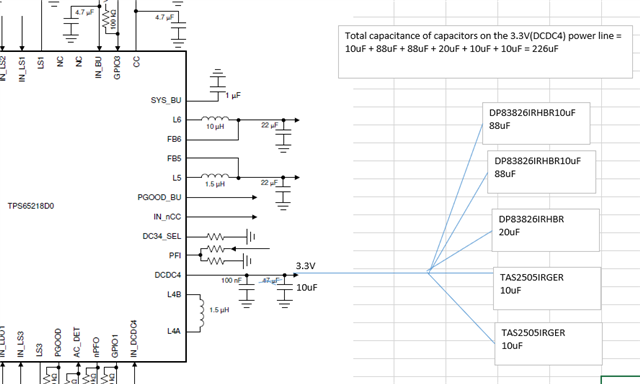

As shown in the image below, the total capacitance of the bypass capacitors connected in parallel to the DCDC4 line is 216uF※Cout 10uF included.
All are multilayer ceramic capacitors (0603~3216m).
Will this cause startup problems?
If so, is there any way to address this, such as lengthening the startup time?
