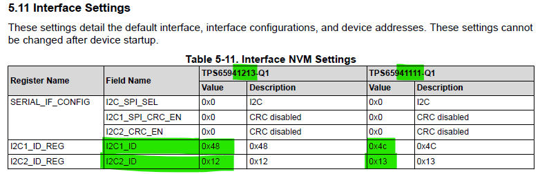

    Thanks for the detailed explanation. The current OPN for PMIC A is "TPS65941213RWERQ1" and PMIC B is TPS65941111RWERQ1. Does this register (0x80) is connected to different I2C interface?
    WD is connected to MCU domain of I2C. Give me more details about it?

  • Hi Manisha,
    For TPS65941213 and TPS65941111 you can refer to the user's guide Optimized TPS65941213-Q1 and TPS65941111-Q1 PMIC
    User Guide for JacintoTm 7 J721E, PDN-0C https://www.ti.com/lit/pdf/slvuc99 for more details about the specific config. In section 5.11 Interface settings you will find the I2C1_ID_REG and I2C2_ID_REG, which are the base I2C addresses for I2C1 and I2C2 on these devices, as well as that CRC is disabled at startup:
    This device uses separate I2C interface, I2C2 on the PMIC, for the watchdog only. So using this information and the datasheet information in previous post, you can use the following as your I2C interfaces and addresses:
    TPS65941213-Q1:
    • User register writes = page 0: use PMIC I2C1 interface, with 0x48 as the I2C address
    • Watchdog registers = page 4: Use PMIC I2C2 interface, with 0x12 as the I2C address
    TPS65941211-Q1:
    • User register writes = page 0: use PMIC I2C1 interface, with 0x4C as the I2C address
    • Watchdog registers: N/A as this is the secondary device and has watchdog disabled (see user's guide section 5.13 Watchdog settings).
    And for the connections between PMIC I2C1 and PMIC I2C2 and the different I2C interfaces on the Processor, see the same user's guide, Figure 3-2 TPS6594-Q1 Digital connections. Note that in this example PDN, EN_DRV pin is not used but is available (so you could use it if needed in your own design).
    So back to EN_DRV status read, you would read ENABLE_DRV_STAT register on I2C1 interface lines, with I2C1 address 0x48, and then use register address 0x82.
    Katie
