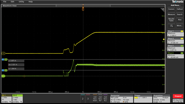

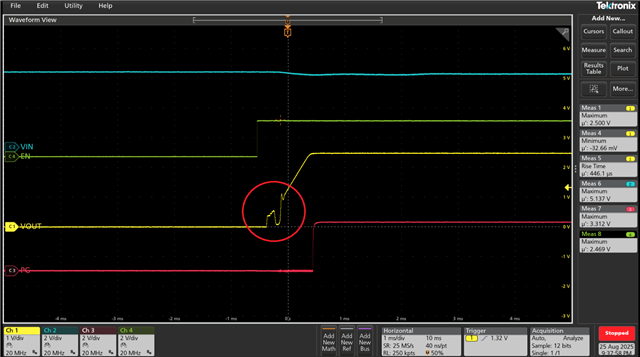

Hi Teams,
The output voltage of the TLV62585 drops during power-on under load(with Eload CC mode >1.5A). The circuit waveform is shown below. Could you please help check if this can be improved? Thanks.
Inductor current is about 3.87A
