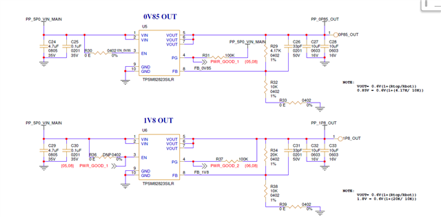

  1. PSB (Power Supply Board):
    • Generates FPGA power rails.
    • 8V → 5V using LTC3119EUFD#PBF buck converter.
    • 5V → 0.85V, 1.8V, 1.2V, 1.1V, and 3.3V using multiple TPSM82823SILR modules.
    • Sequencing is handled using PG and EN signals.

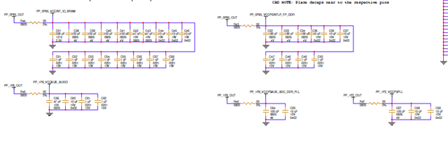

Issue:
  • When we test the PSB standalone, all rails power up correctly.
  • When we connect the SPB to the PSB before powering on, only the 0.85V rail comes up. Other rails like 1.8V and 1.2V do not turn on.
  • If we first power on the PSB and then hot-plug the SPB, all rails (0.85V, 1.8V, 1.2V, etc.) come up as expected.
    Request: Could you help us understand why the TPSM82823SILR modules do not enable the rails when the SPB is connected at power-up?

    There is too much output capacitance on the rails. TPSM82823 supports only up to 47uF output capacitance. The TPSM82823 is probably going into current limit when trying to startup with such high output caps. The internal compensation is also not designed for such high output caps.
    I would recommend to use TPSM82810 as it can support more output caps and also has adjustable softstart time. You need to have a larger softstart time to prevent the device from going into current limit while charging large output caps.
