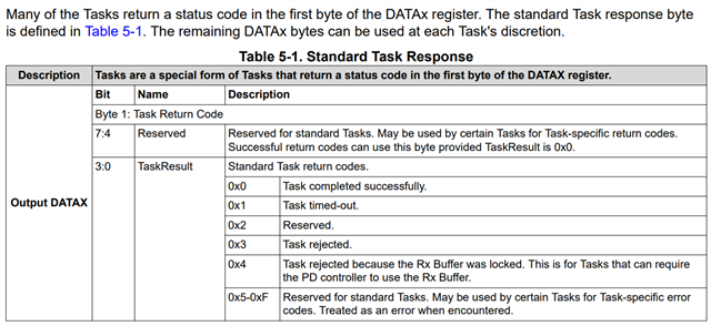

    Can you specify which 4CC tasks you're referring to here? There are different reasons for a 4CC task to be rejected such as timeouts, locked buffer, etc. See table below for more details:

    I'm referring to PBMe, GO2P, DBFg, I2Cr. I'm guessing these return the standard task return codes.
    The interrupts I'm utilizing are I2C_NACK and CMD1 complete. Are there any others I can turn on that'll help?
