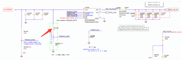

Hi Farheen,
The output of the TPS62813-Q1 with voltage drop during power on in very low probability(1/2000 times).

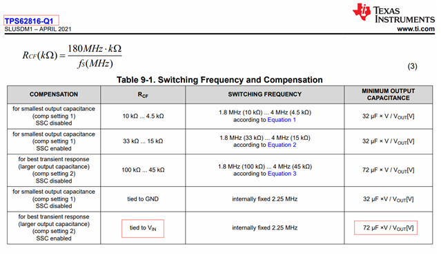

another question ---TPS62816-Q1
1.The COMP/FSET pin is connect to Vin, but the Vout is 110uF(datasheet recommend 200). is there any risk?
2.SCH
Please add your comment!
Hello Jianyan,
For TPS62813-Q1
How much is the voltage drop? Do you have measurement data and schematic?
For TPS62816-Q1
D/S recommends output capacitance of 72uF/Vout if COMP/FSET is connected to VIN, so for Vout 1.8V, it should be minimum of 40uF. Then it looks fine.

Hi Farheen,
For TPS62813-Q1
It occur in very low probability, I don't have measurement data ,but the monitor chip detect it.

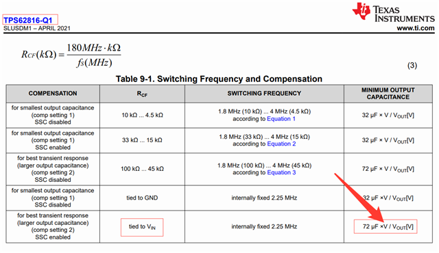

What's meaning of 'V' in the datasheet as below , is it represent the Vin or the voltage unit?
Many thanks!
Hello Jianyan,
The "V" in the equation is part of the unit 72uFxV. It is not VIN.
