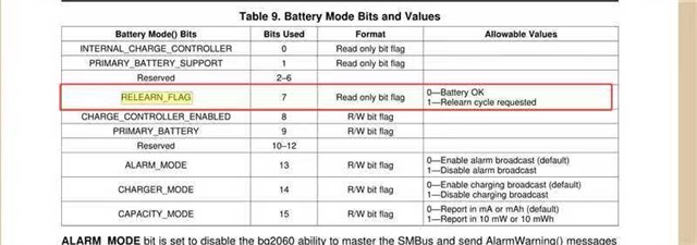

The new charger project uses the TI BQ2060A fuel gauge. The customer requires that our charger can automatically enter the health status re-calibration mode, with the conditions being: receiving the Condition Flag and the current State of Charge (ASOC) < 15%. However, how can we make the fuel gauge chip send the Condition Flag information? Or rather, how can we determine whether the chip has sent the Condition Flag information?
Currently, our corrected procedure is as follows: After detecting that this position is activated, if the current battery level is below 15%, discharge will start. When this position is reset to 0 or the battery level is discharged to 0%, it will re-enter the charging state. We are not sure if this procedure is correct.
